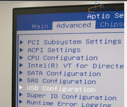

开机一直按delete键进入bios
advance --> usb configuration

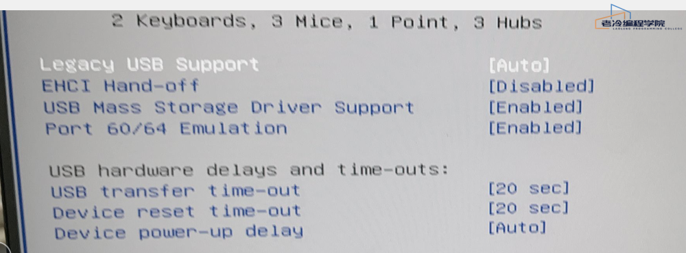

legacy USB Support 改成Auto
如果不行,按照下图设置
